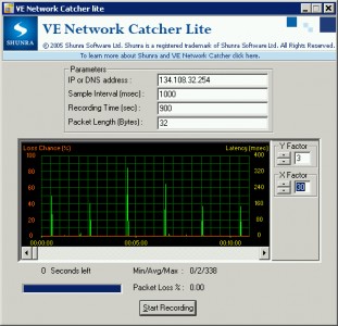

We have one Cisco Router 6506. When I ping the local interface of the router, it responds always within 1ms. But every 2 minutes, the Router latency is at ~800ms for nearly one second. This repeats every 2 minutes.
We have no paket loss. Problem is, this effects also VoIP, which will be delayed, too.
What could be the reason for this periodically delays?

I did more tests.
Pings to other vlans (Esslingen,same location) are not affected - but one. We have a BSD-VPN-Router connected to this interface/vlan, which is connected to an other router (B) at an other location. All Hosts after B are delayed after 2 minutes for one second
The interesting part is, that pings to the BSD-Router and Router B are never affected.
Here you have an mtr-graph from Ping_Host (look at Wrst)
17:32:09 2006
I want to do VoIP with Location_B, but you see that everything is delayed after 2 minutes (at the same time, when Route_A's Latency is high , $any_HOST_at_B is too)
We will check that tomorrow, Patrick
