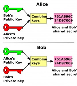

If the WPA2 is using something like public key encryption method, it is still impossible for attacker's to obtain the wpa2 passphase using the key swapped in the air traffic, to understand this, please read:
