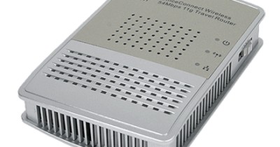

Okay, what I have is a laptop computer and I don't have the PCMCIA card option, so I am just wondering if something like a wireless ethernet bridge would allow me to get access to a wi-fi network when staying at a hotel, etc.
"J&D Schnoor" hath wroth:
Absolutely. Methinks a "travel router" might be suitable. It is especially useful if you want to connect more than one device, such as a VoIP device. For example:
If these are overkill, then a simple wireless ethernet bridge will do. There's a list of possible candidates at:
The main problem is that unlike a wireless client that has all the connection information configured inside your laptop, both the wireless routers and wireless bridges need to be configured inside the router or bridge. Therefore, connecting is a 2 step process. First you select the SSID of the hot spot using a web browser pointing to your wireless router or bridge. It then issues your computer an IP address via DHCP. You can then connect to the hot spot and authenticate using the web browser. It's an additional step that sometimes causes some confusion, but that's the price of having an external ethernet connected wireless device. Note that some "travel routers" have a utility to make make this easier by storing commonly used connections on the laptop instead of inside the travel router.
Also, you might want to look around your unspecified model laptop and see if there is a USB connector available. If so, a USB wireless adapter is probably cheaper and easier to deal with.

Thank you for all of the replies so far. I have been out of town for a few days so I haven't had a chance to get back to this until now. Unfortunately, neither PCMCIA nor USB is an option in this particular case. I did get a chance to try a Belkin Wireless G Gaming Adapter and that did work, so now I am trying to narrow my focus on if I should buy a:
-Wireless Travel Router
-Wireless Gaming Adapter
-Wireless Ethernet Bridge
I suspect that I can probably eliminate a wireless ethernet bridge because I think that the wireless travel router and wireless gaming adapters will be more compact for travel. (Is that correct?) I am trying to get the best value for my money, of course. I suppose having the ability to connect an external antenna could be helpful, too, on occasion. The Belkin Wireless G Gaming Adapter that I tried seemed pretty good, but I just want to make sure that I don't buy it and then find out a week later that a different brand is better for whatever reason, be it price, range, ease of set up, etc.
