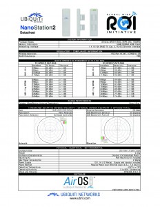

The problems are largely solved if we disable the onboard AP and drive any of the ubiqitti AP's from the public lan port. For some reason Ubiqitti radios (especially the NS2) have a fantasically high sensitivity and while fully appreciating your comments about saturation / SNR etc with over amplifying, the sensitivity of the receivers on NS2 is I think in the order of -95 to -97 dBm. Certainly they are the most effective units we have EVER found when it comes to connecting weak clients (talking more about specific applications over a distance here not hotspot)
To be honest, although I am not adverse to playing around with transceivers, once they get into UHF (and high end of UHF too), it has gone way past my skills to make neat cuts / connections etc on PCB's where an extra 1mm of track in the wrong place can suddenly make the whole thing go downhill in terms of performance.
Give me something working at a few Megs and I will tinker all day :)
I think I was just hoping someone would come back and say something like "You need the RX+12 from whizzlec for about £25" - alas they didn't :) I think the simplest answer is to stick with the NS2 solution. It seems wasteful but it DOES work and it IS simple.

I just hate agreeing with you, but Ubiquity stuff works well (and is cheap). I recently replaced some WAP54G v3 pieces of junk with Ubnt Bullet2 radios. It was a major improvement. However, I won't say anything nice about their non-802.3af PoE injector. Retch.

Ummm... careful when you read the data sheets. Everyone lies except amazingly Dlink. The RX sensitivity numbers are invariably direct copies of the chipset sensitivity from the Broadcom or Atheros data sheets. In the distant past, I started researching the numbers and produced a spreadsheet and graph demonstrating the hype:
The Dlink numbers are real measurements. Also note that the numbers for the Ubnt Lighstation is about 3dB better than any of the other units, which makes me wonder what they're doing.
