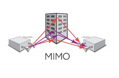

We use wireless at market research meetings where we use wireless between the viewing room and the interview room through a one way mirror. The stability of the wireless connection is cause for concern - it occasionally drops out. I appreciate that this often happens with 802.11g wireless - it happens at the office and it happens here at home.
802.11n (MIMO) is touted as having increased range, increased speed and increased stability. The first two are obvious to demonstrate but what about increased stability?
I suspect that the problem we get is a combination of sending the signal through a silver mesh (the one way mirror) plus other surrounding wireless networks causing the signal to bounce all over the place. 802.11n is supposed to work with this effect instead of fighting against it so it could be better.
Comments?

Where did you get the idea that you'll get increased range with MIMO? Basically, you can trade range for speed. Double the range, and you have to slow down to 1/4th the speed. Similarly, cut the range in half, and you can go 4 times as fast. For long range, you'll never get faster than 802.11g speeds. MIMO is about improved resistance to reflections and multipath. 802.11g sorta tolerates multipath by being tolerant to frequency selective fading. MIMO uses the multipath to create additional data streams (spacial multiplexing), which will increase the speed, but not the range.
I've never tested a one-way mirror for RF attenuation. My guess is that it's about the same as aluminized reflective window coatings commonly used in office buildings for energy efficiency. These block signals like a brick wall. You're lucky that any signal goes through.
The surrounding wireless networks cause interference. If this is the case, move the access point to a less polluted channel (1, 6, or 11), move the access point away from windows and doors so that it doesn't pickup as much junk, or elect public officials that don't support municipal wireless networks running high power (1 watt) radios.
Pre 802.11n Draft 2 is suppose to be faster. It's also somewhat more resistant to reflections. It slows down to 802.11g modes in the presence of interference and is therefore no better than 802.11g. I guess you can call that more reliable.
Keep it simple. Play with antenna patterns. Change channels or bands (802.11a is less polluted for now).
Also, don't elect officials that promote "free" wireless networks that neither work or pay for themselves.

OK, I'll bite. It says: "We were impressed with MIMO's range capabilities and found it delivered exceptional coverage in a normal home environment."
The big question is what they mean by "coverage". Also whether they were testing in the various MIMO modes, or were falling back to the
802.11b/g modes when testing the coverage. I'll leave it an open question as I fail to see any substantiating numbers. They do indicate that the MIMO router is more "reliable" which they interpret as experiencing fewer dropouts. My guess is that they were testing in a highly reflective indoor environment, where MIMO does do better.
Well, there you have me. The article mentions: "MIMO technology has attracted attention in wireless communications, since it offers significant increases in data throughput and link range without additional bandwidth or transmit power."
However, searching the article, I find no substantiation of this claim and no furthur mention of the buzzwords "range", "coverage", or "distance". In short, it's another recycled claim devoid of any substantiating numbers.
Then, you should be getting "MIMO performance", which is a good thing. The major benifit will be increased speed and a much more reliable connection with fewer disconnects due to reflections and multipath.
