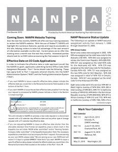

On Friday night, 09-April-2010, NeuStar-NANPA issued its 1Q-2010 Newsletter, uploading to the NANPA website:
On page 5 of the six-page newsletter, in the "News Brief" section, there is the following blurb (fourth paragraph):
"DSMI, the FCC's designated Toll Free Administrator, has notified the FCC of the projected exhaust of current toll free numbers and requested approval to release the 855 NPA code. Timeframe for availability of 855 numbers is no later than 4Q-2011."
SO... it looks like after over ten years now, there could be some new toll-free numbers of the 855-nxx-xxxx format!
