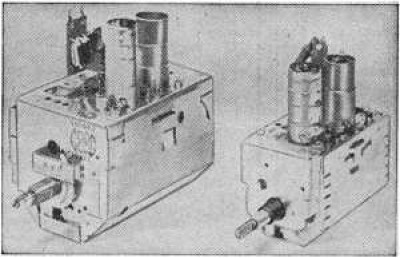

But by the 1950s, TV set manufacturers were installing "turret tuners" to simplify VHF tuning. A single knob rotated a cylindrical mechanism fitted with twelve little hand-wired circuit boards, one for each channel. Each circuit board had a bunch of capacitors, some hand-wound coils, and a row of metal contacts that mated with metal springs. As each circuit board was brought into position by the rotating mechanism, the springs mated with the contacts on the board, placing that board in the circuit.
After the introduction of UHF, turret tuners were manufactured with 13 circuit boards, one for each VHF channel + one that switched to a separate UHF tuner. The UHF tuner was tuned in one continuous-tuning dial.

On each channel, the fine-tuning control engaged a tuning slug inside one of the little hand-wound coils.
Here's a link to a picture showing a turret VHF tuner (left) and what appears to be a continuous-tuning UHF tuner (right). This particular photo happens to be on a British website, but the basic structure of the turret mechanism is the same in the USA.
