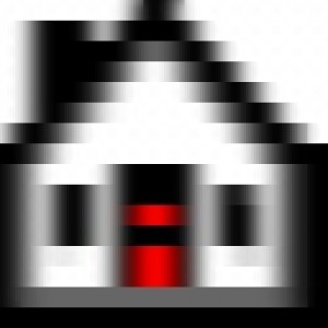

I've just started putting together a home automation 101 page. It's X10/Insteon and it's not done yet. 's still needs work, for instance, I haven't added the section discussing the Wireless APs that you use with the wireless remote and to connect the phases (needed for homes…
FAQ? open original image
Is there an quick reference for z-wave and insteon so that after reading them, I will know the devices I need to accomplish a certain task. The FAQs I could find are manufacturer's marketing stuff and does not go into technical detail.
It's still needs work, for instance, I haven't added the section discussing the Wireless APs that you use with the wireless remote and to connect the phases (needed for homes that have two 120v phases).
the long/short slots on the wall outlet seems to be reversed
one of the things I would love to see is a diagram showing representative devices (remote, controllers, light switch) and signal path showing how radio and powerline signals traveling to/from each device. From this illustration, one should be able to tell that a hand held remote cannot talk to powerline device directly (which I think is the case for insteon, not
100% sure).
The diagram implies that RemoteLincs both transmit and receive RF. Is that true?
