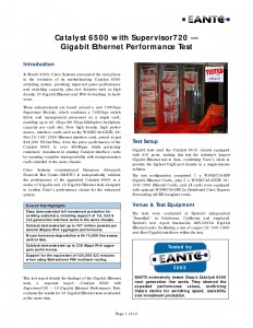

If you examine the following report, you see that at least for the Cisco 6500 with Sup720:
- IPv4 layer 3 GbE latency is less than 12 1/4 microsecond avg, 16 1/2 us max
- worst case layer 2 forwarding is the same as worst case layer 3 forwarding (i.e., the limiting factor was the switch fabric speed at the worst- contention case)
- best case layer 3 forwarding is only 0.02 Mpps worse than the best case layer 2 forwarding
- layer 3 forwarding with a 10,001 entry ACL was the same as layer 3 forwarding with no ACL
Effectively, then, on that device, layer 2 and layer 3 performance are the same.
