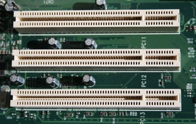

WRT PCI-X cards working in PCI slots, IIRC they only work in 64-bit
3.3v PCI slots, and that may also mean 66 MHz, not 33.

In my case it was MCA, and also for S-bus. Fast ethernet S-bus is probably affordable now. I knew about one 100baseTX MCA card, but they were rare, and I heard not very fast.
My understanding is that the speed of a PCI card is the maximum speed, so a faster card should work on a 33MHz bus at 33MHz.
A PCI-X card with the right notches should work in a dual voltage slot, but not in a 5V only slot.
I believe the one in the picture
There seem to be many PCI-X 1000baseSX cards on eBay, and it looks to me that they have both 3.3V and 5V notches. I don't know about the repeater/switch/hub, though.
