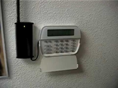

What is the Gadget Flashing?

It looks like a GSM communicator. What a cheezy installation. Jim Rojas Technical Manuals Online! Cornwall Lane Tampa, FL 33615-4604 813-884-6335 813-440-6653 Fax AOL: rojas813 MSN: Yahoo: jimrojas ICQ: 20116219 GoogleTalk:

What is the flashing device that's connected to this DSC panel?

Can you think of any reason why anyone would put a communicator on the wall next to a keypad? Other than laziness, that is.
RHC: How about incompetence - that's nothing new in this industry !
I don't know anything about the Alexor panels except that I heard that there was some kind of problem with it regarding loss of wireless communication without there being any notice, which DSC denied. So it's just the word of a central station who lost contact with all of it's Alexo panels at the same time for a day or two, against DSC who said it must be something that the central station did wrong.
However, if that green light is really on a GSM receiver that's sitting next to your keypad, I'd really find another alarm company to deal with. That device should be hidden away somewhere so it is not just hanging on the wall beside a keypad. I mean come ON! it's a security device that if compromised by an intruder could cause the system to not communicate with your central station. It should be installed kind of hidden away somewhere and as high as possible in the house to obtain the best communication advantage to the local towers in your area. And even if it does do that being mounted beside your keypad, it looks like someone just got lazy and couldn't be bothered making the installation look professional to some degree. Seeing this makes me wonder what ELSE ..... they didn't do ..... that you can't see.
I'd certainly get someone else in to give you an estimate and see what they say when they see the location of the transmitter.

Looks like a cell unit although none I'm familiar with, I posted the question on YouTube
