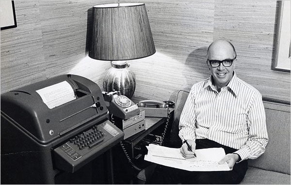

Excerpt from the New York Times:
Dr. James Marsters passed away. He and two deaf colleagues broke that barrier for themselves and tens of thousands of other hearing-impaired people in 1964 when they converted an old, bulky, clacking Teletype machine into a device that could relay a typewritten conversation through a telephone line. It was the first example of what became commonly known as a TTY and is now, in a greatly updated and compact version, called a text telephone.

Marsters, Weitbrecht, and Saks solved these problems with a combination of innovation and elbow-grease:
  1. They chose to use the older Model 15/19 and Model 28 Teletype machines which ham operators were also using. These machines were nearing the end of their commercial life, and were relatively inexspensive.
  1. They designed and built a half-duplex modem which is compatible with telephone answering machines: it could be used to record an outgoing message which would be printed on a caller's machine, and also to leave a message for later printing by the recipient.
  1. They included automatic Transmit/Receive switching, which allowed for calls to be made where one party was using a TDD and the other was speaking, as in the case of late-deafened adults.
