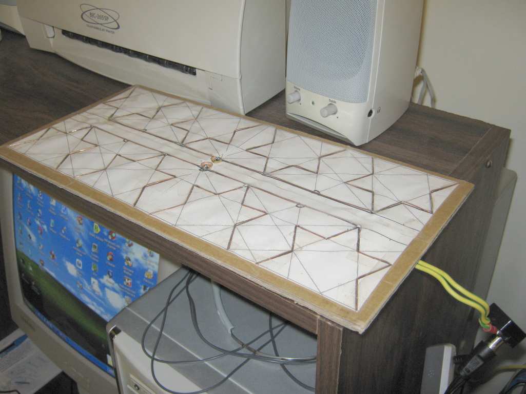

A while back I had a slightly OT discussion regarding the practicalities of fractal antennas for HDTV.
I subsequently made an 8 element version and it works very well in areas of no line of sight/poor reception.
I don't use a reflector on this and it's interesting that the antenna works well on both the horizontal and vertical plane indoors.
See below using on the horizontal.
So any insight into which plane is optimum for this type of design ?
I was quite surprised that it works in the alignment seen in the picture.
Could it be used as a beam antenna with a suitable reflector at one end ?
Maybe it's just picking up a reflected/multipath signal from the metal roof ?
