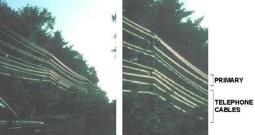

True. However, telco cables can be pretty heavy too; I've seen multipair cables almost two inches diameter. In order to prevent sag, strands supporting big cables like this have to be placed under high tensions, often several hundred pounds. Further complicating the situation, some polelines carry two or more telco cables. An extreme example:

Add three inches of radial ice and a 100-mph wind, and communications cables can put a huge lateral force on a poleline.
