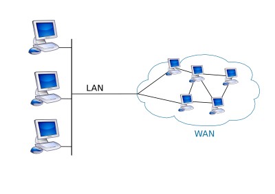

why are you people so touchy? I was TRYING TO FIND OUT what server you were talking about, so i asked you, and now you unload a ton of crap on me. I was told by verizon FIOS was not a wan, so it was not subject to a slow down like comcast, which is a WAN. are you saying that giganews servers or a commercial newsfarm is the server that is more congested because of FIOS?

Hmmm, you might find this definition illuminating.
Both are WANs. Comcast had problems with their overloaded auth servers so I added code to my usenet script to watch gateway ping times to give me a heads up when the gateway and/or news server was slow.
