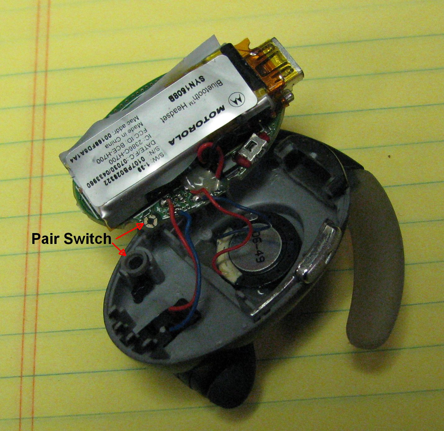

Motorola H700 bluetooth earpiece dissassembly instructions (Jeff L?)
Anyone have pictures of how to open the Motorola H700 bluetooth earpiece?
Googling, I found a "JeffL" picture of the opened earpiece over here:
And, I found written instructions (but no pictures) over here (& elsewhere):

Unfortunately, all three references have DIFFERENT instructions for opening up the Motorola H700 clamshell - so that's why I ask (I wonder if JeffL is the famous Jeff L. of this newsgroup?)
And, none of the references show anyone actually disassembling the earpiece. For example, this reference (wrongly) tries to explain how to open the H700
This one refers to disassembly photos on a geocities site that no longer exists:
Here's the geocities Motorola H700 disassembly instruction site that's gone:
Q: Does anyone know how to resurrect those Motorola H700 disassembly pictures?
